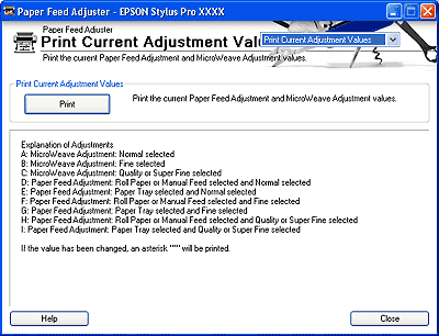

Print Current Adjustment Values Dialog Box
Print the current Paper Feed Adjustment and MicroWeave Adjustment values.
Click the Print button to print current adjustment values. The following sheet is printed.
a: Values of MicroWeave Adjustment settings
b: Values of Paper Feed Adjustment settings
c: Marking on the changed value using EPSON LFP Remote Panel
d: Media types with various print settings
Letters A or B in the column heads refer to the adjustment setting of MicroWeave or Paper Feed Adjustment and print settings. The detailed information of the print settings is shown in the Print Current Adjustment Values dialog box.
The diagram shows the current adjustment values for each media type. If the value was changed, an asterisk (*) is shown next to the value.
The numbers with the sharp symbol (#) in the row heading are media types combined with various print settings. The number varies depending on the media type, the resolution setting, the paper source, and so on. This number corresponds to the number shown next to options in the Media Type list box in the Adjustments dialog box.
