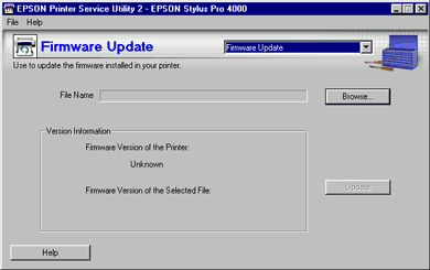

 The following screen appears. Make sure that the printer firmware is shown below the Firmware Version of the Printer.
 Click Browse to select the firmware update file.
The file version will be shown below the Firmware Version of the Selected File in the Version Information box.
 If Newer or Same is shown, you can click Update to update the firmware.
Older files cannot be used for updating the firmware.
 Follow the on-screen instructions. If you cannot perform a correct update by following the on-screen instructions, follow the steps in the Note below in the order described.
Reconnect your printer using a USB cable, then turn the printer off and back on.
Change the printer port to USB connection in the EPSON Stylus Pro 4000 printer driver.
Go to the top screen of EPSON Printer Service Utility 2, then make sure that EPSON Stylus Pro 4000 is selected in the Printer list box.
