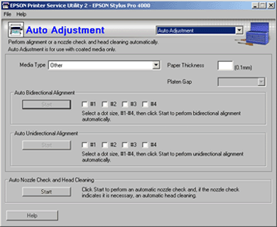

Perform the automatic Nozzle Check and Head Cleaning, Bidirectional Alignment, or Unidirectional Alignment for coated media.
| Note: |
| Note: |
![]()  | Select the media type you use from the Media Type list box. If you use non-EPSON media, select Other. |
![]()  | Set the Paper Thickness. |
If you selected EPSON genuine media name, the value appears automatically.
If you selected Other (non-EPSON media) for Media Type, type the value of the media in the Paper Thickness text box, from 1 to 15. For paper thickness information, see the specifications or contact the dealer for the media.
| Note: |
![]()  | Set the Platen Gap. Platen Gap is the height from the media loaded into the printer to the print-head. By adjusting this parameter, you may produce better image quality. |

![]()  | Select an ink dot size from #1 to #4 depending on the media you use and the print mode you want to try. The table below illustrates which parameter is available for the media and print mode. |

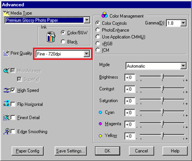

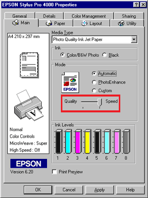

| * Print Quality A: Draft, B: Speed, C: Quality, D: Normal, E: Fine, F: Super Fine, Super Photo, Advanced Photo, Advanced Photo 2880 |
For Print Quality, refer to the printer driver.

![]()  | Select the checkbox on the left to your selected number, from among #1 to #4. |
![]()  | Click Start to perform automatic Bidirectional Alignment. |
| Note: |
![]()  | Click Start to perform automatic Unidirectional Alignment. |
Check if the ink jet nozzles are clogged. Click Start to perform an automatic Nozzle Check. If necessary, automatic Head Cleaning will be started.
