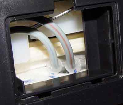

2. Replace or Clean the Ink Pads or collect any future excess ink in an external box
What is, "waste ink?"
There are a set of super absorbent pads inside the printer that catch, store, and disperse ink that is not used by the printer directly.
Ink is used when the printer starts up, shuts down, cleans, and prints - and when there is extra ink, it has to go somewhere.
That somewhere is the waste ink pads, and they do get messy when you print in high volume (500 pages or more per month).
This system is designed to re-route all the extra ink that is dispersed during cleaning, and printing,
into an external waste ink container. This way the waste ink pads stay dry and clean.
Installation is similar to replacing the waste ink pads, however the tubing is attached to an extender tube and
the waste ink is re-routed outside the printer. Very clever actually.
