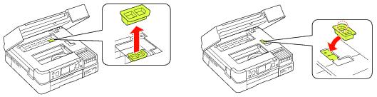

- Make sure the transportation lock has been removed.
Store the transportation lock as shown below.
