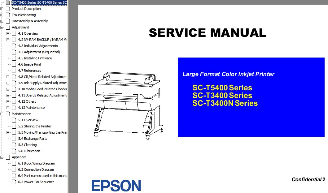

This Epson Sure Color SC-T3400, SC-T3405, SC-T3430, SC-T3450, SC-T3460, SC-T3470, SC-T3480, SC-T5400, SC-T5405, SC-T5430, SC-T5450, SC-T5460, SC-T3570, SC-T5480 Service Manual describes basic functions, theory of electrical and mechanical operations, maintenance and repair procedures of the printer.
- Block Wiring Diagram
- Part names used in this manual
- Power-On Sequence
